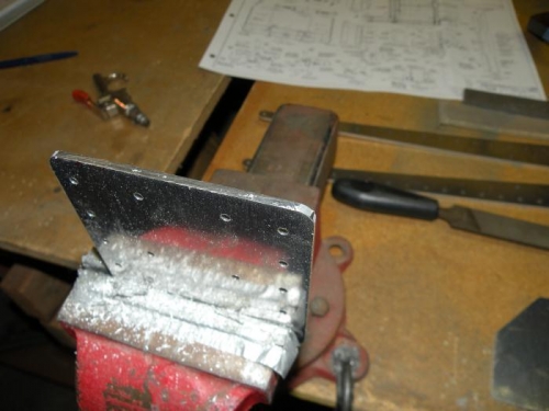

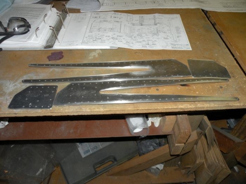

Tonight I started on the W-407G rear spar reinforcement forks and W407D doubler plates. As received they are the same parts as used on an RV-8, but get trimmed on the bottom inboard corner for the RV-7 per drawing 38 (only available in the preview plans at this point). I carefully measured, marked, and trimmed one, then used it as a template to scribe the trim lines onto the other 3. To trim each one, I cut within about 1/32" of the scribe line on the bandsaw, then hit the edges with the belt sander, both individually and a light touchup as a clecoed stack.
I used the vixen and mill files to do the initial deburring of the edges of all 4 parts, then used a combination of scotchbrite wheel, 100-grit sandpaper, and maroon scotchbrite to break the edges and finish them up. I used the sandpaper and maroon scotchbrite wrapped around a sharpie pen to smooth out the inside radius of the forks.

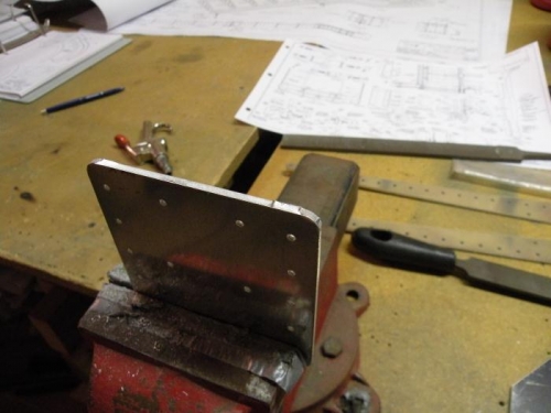

Edge of a rear spar root reinforcement plate as received.
The same plate about 15 strokes of the vixen file later.
All 4 root reinforcement plates trimmed, edge deburred, and designated right and left.
