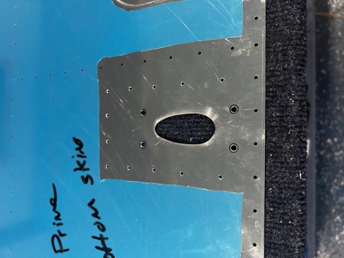

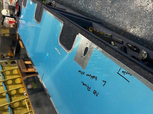

Brief Description:  Cutting Pitot Hole in Bottom Wing Skin
Took a couple hours and got the skins ready for priming by dimpling all the holes. The left skin was a little extra time consuming because I had to cut the access location for the Pitot mount. I will be countersinking the skins where pitot doubler plate will be attaching so I did not dimple. I only dimpled the ribline holes.
These photos are pre dimpling. I did not take any photos after dimpling. I did use a soldering iron to remove blue plastic in sections of dimpling.
Wing tips is the only thing left to do before the wings are complete.
all holes drilled and mount hole  cut final size
complete left skin ready for priming
