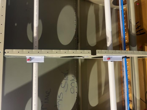

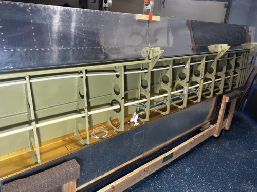

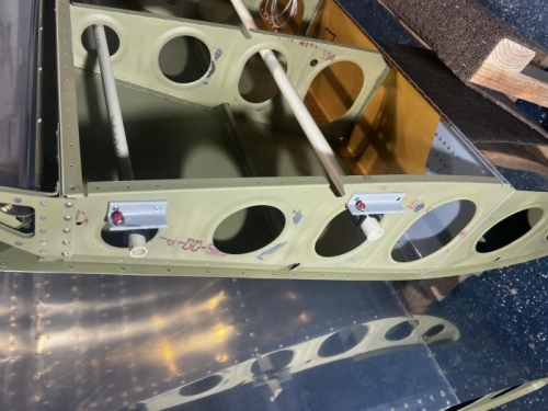

Installing wing conduit
Used CPVC to for wing conduit. I used 3" piece of AA, LP4-3 rivets, and AN3-4a bolts to complete the mounting.
right wing conduit
