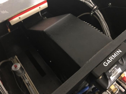

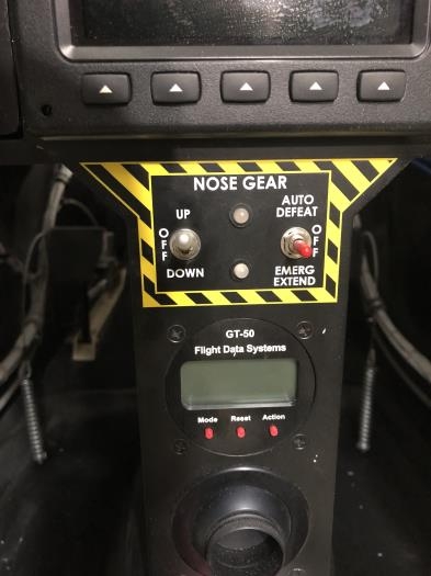

Even though I really didn't want to remove the nose gear actuator cover again, I knew that there would be an abundant amount of filler and primer dust along with a couple chores that needed to take place so I shrugged it off and went for it. This job included fine tuning of the actuator limit switches for maximum throw, re-greasing the guts n gears and cleaning out all the dust :) She now runs much quieter and gives me a bit more nose up angle. This was an hour well spent, but greasy fingers meant fewer pics :(
Cover is coming off again
regular TLC
regular TLC
