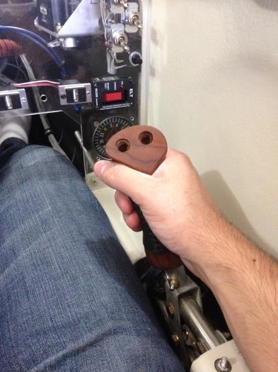

Tomorrow the pilots PTT and AP disconnect will be wired up to the stick grip so I needed to install the grip. On a scale from 1-10 for comfort I'd have to say that I'm still sitting at only a 7 for my stick grip. I can't say why my hand is so picky but I still haven't found that "perfect" grip feel. I'm hoping I'll get used to it and be happier but for now I slipped it over the tube lathered in Silicone adhesive and got it in the best position I could find. No going back!

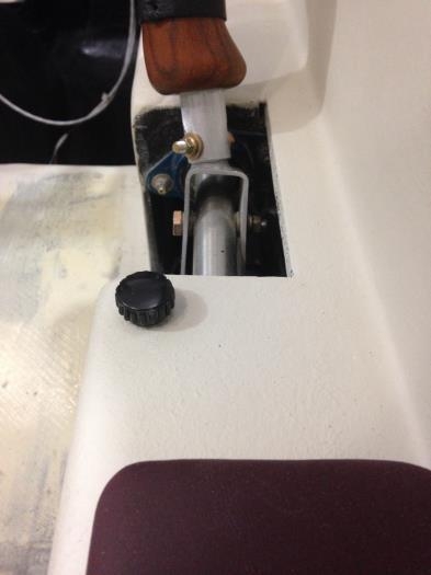

Second task was to remove the Nut from the Roll trim assembly and install the small 5mm threaded knob I got from China. Works fantastically well and looks great. Done.
final position and installed
Roll trim knob is on
