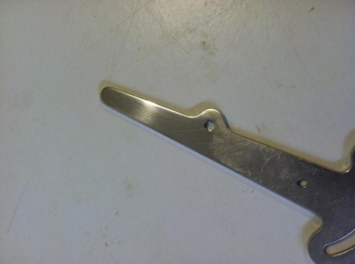

Brief Description:  Polishing Trim lever
After spending 2 hours on the grinder trying to make it appropriate for polishing, I realized it wasn't going to work. I started by sanding the part with 40 grit all the way up to 1000 grit and probably could have spent more time on it but was satified enough at this point to begin polishing with compound and my dremel. It came out pretty good so I'll call it a success.
not chrome perfect, but good.
