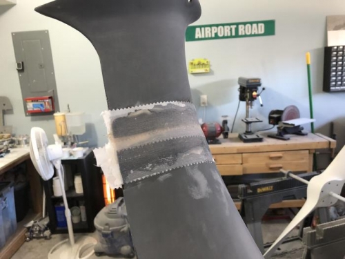

Gear Leg Fairing BID fix
At the joint of Klaus' gear leg fairings, the flexing loads were causing the finish to split. I went ahead and added 2 plies BID with West systems to the joints to solve the issue.
2 plies Bid tape
