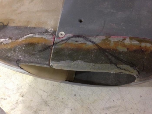

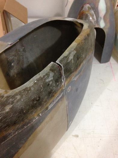

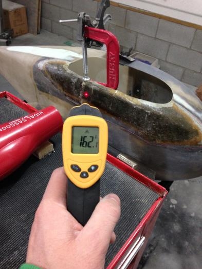

After trimming up the pants and puting the halves together I noticed that the carbon layups warped one of the halves pretty bad. No problem I clamped it into position and used a hair dryer to heat it up to 160 for a while and let it post cure. After only 30 minutes, it stayed in that position. Easy fix.
