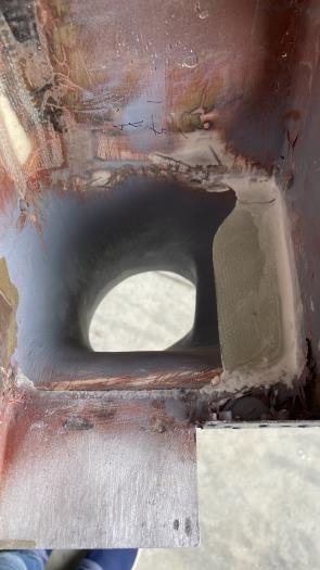

Brief Description:  Closer we get
Inching forward one test flight at a time. So far the forward baffle added is too restrictive after it's first trimming. More area will be removed for the next test. The right bank is within 7 degrees of each other, and now the left is gaining momentum. Few more adjustmets and CHT's will be well balanced.
adjusting the baffle
