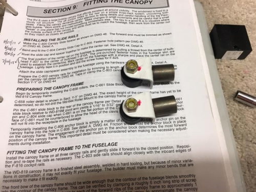

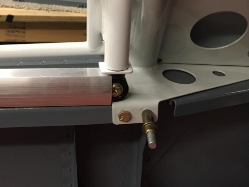

This is the section of the instructions that I got thru with tonight…well sort of. I put the uncut parts on the fuselage to orient myself – making sure that the angled cut is at the aft end and the c-shape is pointing outward. I then measured the left one and cut it to the specified dimension. I was going to use the bandsaw but the rail is fairly thick so I ended up cutting it with a hack saw with the part clamped in the vice. After cutting the left canopy rail, I smoothed it on the scotch brite wheel - then went to measure and mark the right side. I cut the right side and smoothed it as well and set the right canopy rail next to the left canopy rail…and wondered why the left one was shorter? Upon re-measuring, I noticed that I cut the left canopy rail a half inch short!! I measured it more than three times – but the only thing I can think of is that since the part is supposed to be cut to 45 & 7/16 inches – I was so focused on backing it off by that 1/16” from the half inch mark, that I backed up too far and cut it at 44 & 15/16” …Dang it... I put together the other parts of the canopy slide rails and the canopy frame to get a sense of what kind I problem I had – and yes, this will not work with the shortened canopy rail on the left side. Glad this is only a $15 part (before shipping, of course!)
I went ahead and finished on a positive by putting the two canopy rollers together and torqueing the nuts to 35 in/lbs. (Not easy to do with a screw head). Off to order another left canopy rail.
