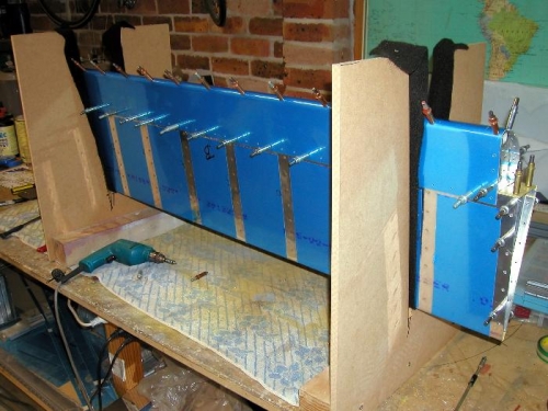

Brief Description:  Bend aileron skin and assemble aileron
After bending the aileron skin, I assembled the entire structure and back drilled all the holes to the required size. Everything was then disassembled, deburred, edge finished, dimpled and counter sunk.
Bending the skin to the correct angle
Right aileron assmebled and back drilling started
Back drilling completed, including the counter weight
