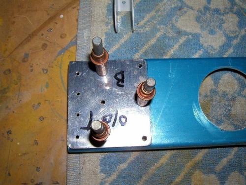

It took me a little while to find the requried .0040 material to make the doublers for the rear spar, I could sware I made a set for this aileron when I made the parts for the left side. Oh well, doublers re-made and back drilled to the spar. With this done I back drilled the hinge brackets, disassembled, deburred and etch primed. While I am waiting for the primer to setup I'll bend the aileron skin.

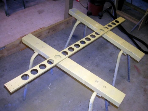

Made barckets for both the I/B and O/B ends of the spar
