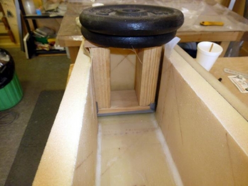

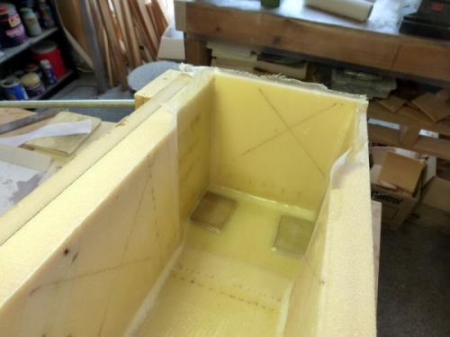

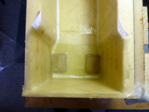

Brief Description:  Outside Inner Spar hardpoints
I did the outside hardpoints first where two LWA-1 pieces are placed.
Its 1 ply of BID over the lot... back, bottom and sides for a few inches, then plys of UNI, then floxing in the metal and then one ply of BID on top. I really spent time on this ensuring things were going in the right places!
Peel ply at the end to keep it tidy on the edges and then the weights as shown in the first pic.
Noone gets to see this later. So I took a lot of pics. This is of real structural importance. While not perfect, the work here is sound.
Hardpoint clamp

LHS end hardpoints
LHS end hardpoints
RHS end Hardpoint
RHS end Hardpoint
