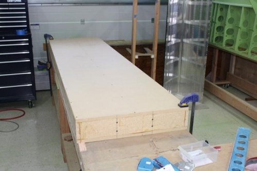

Step 1: Identify all aileron parts. Leveled the torsion box. Had it stored on it's side for a week or so and noticed it took on about a 0.1 to a 0.2 deg of twist so in the photo below you can see the wedge under one end and the clamps on the opposing ends. I'll let it set this way for a month or so while I am out of town on busines and see if the twist comes out. It is a very rigid structure but with enough force anything is possible.

Leveled the Torsion Box
