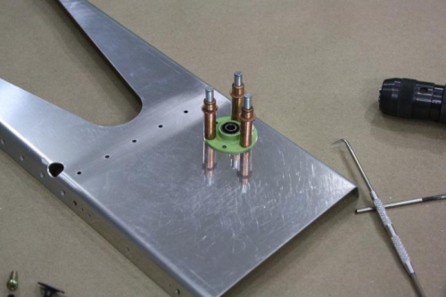

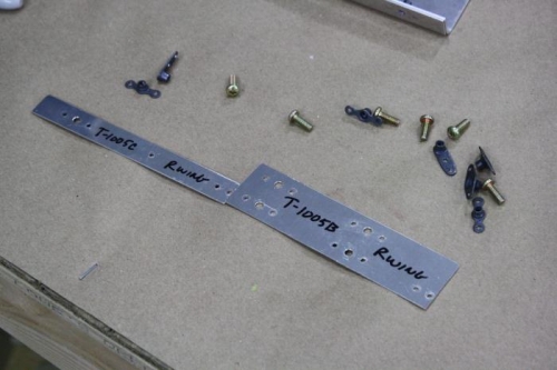

Step 1: Shaped nd deburred T-1005B and C shims.
Step 2: Final-Drilled shims with #40 reamer and #19 drill bit and deburred.

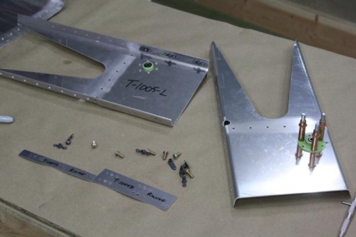

Step 3: Checked orientation of all parts to be a mirror image of the assy for the left wing. Clecoed VA-146 bearing into place.
