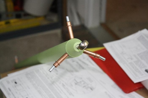

Step 4: Install threaded insert and pop rivet with MSP-42.
Step 5: Install the Elevator Pushrod in Tail Cone and connecting to Elevator Horns and Bellcranck assembly.

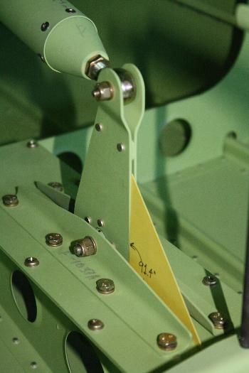

11-7:
Step 1 : Secured the elevators in the trail position with small padded clamps.
Step 2: Adjusted the Pushrod to the specified 91.4 deg angle on the front edge of the Bellcrank Assembly.
Step 3: Tightened jam nuts against pushrod threaded inserts.
Step 4: Checked the elevators for interference and rechecked up and down travel. Removed pushrod, check jam nuts for tightness, and applied torque seal inspection material. Removed pushrod.

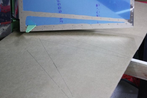

Step 5: Installed rod end bearings with jam nuts into Rudders as the specified centerline height of 3/4 in.
Step 6: Installed Rudder and checked center bearing alignment. Adjusted center bearing out 1/2 turn for alignment and reinstalled Ruder.
Step 7: Checked Rudder for 35 deg travel left and right. The right required 1/2 deg more to reach 35 deg. Used sandpaper between the stop and the striker pad. Didn't take much to move 1/2 deg.
Ends Fitted, Ready for Pop Rivets
Pushrod Adjustment 91.4 deg
Checking Rudder Travel
