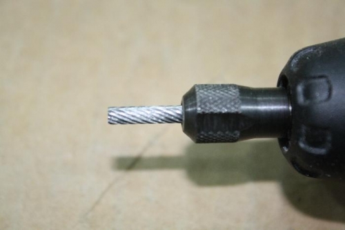

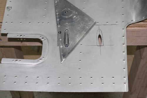

Decided the add Rudder Cable Farings to Tail Cone side skins prior to priming. Cut a template in thin cardboard first, trimmed with Xacto knife then practiced cutting the hole for the fairing on a junk piece of aluminum skin. I used a straight metal cutting bit in a Dremel hand grinder which worked well.
