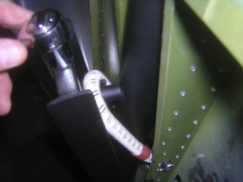

Installing Nose Gear Bungee
Note: This tool was purchased along with another tool for drilling holes into the main gear from Kobush Welding in June 2006 (see expense log) for vendor info
Position bungee on gear

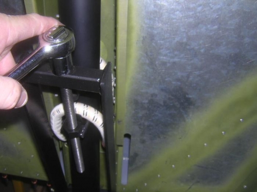

Use tool to put bungee into position

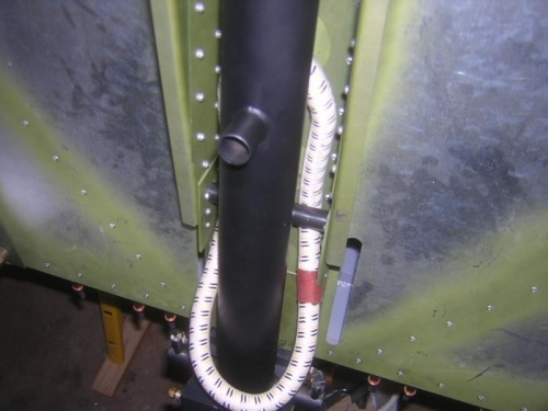

Now just tip bungee over the top support post
