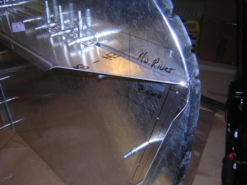

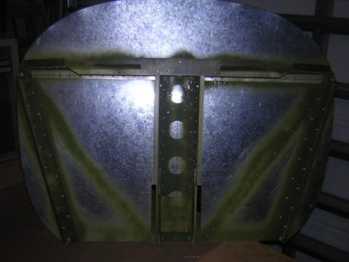

Set up vertical and horizontal reference lines using straight edge and level. Rather than having a level table, I leveled a 2x4 and placed the fire wall on the board.Once the reference lines were made, the rest has been fairly easy. The second image shows all the parts zinked and riveted in place. The third photo shows the nose gear in place temporarily.
