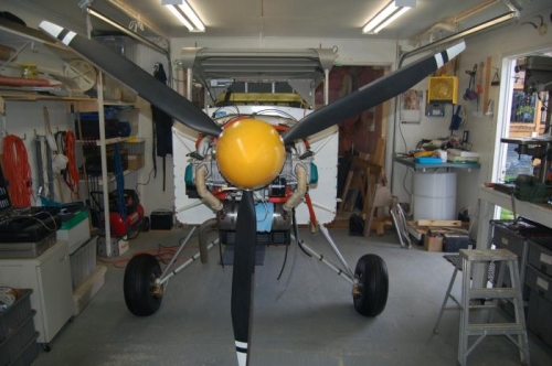

Brief Description:  propeller
The Warp drive propeller is in place. Adjusted the 3 blades to 10 degree pitch. Following the advice of another pilot, it is correct to adjust the blades to 10 degree during the break in period.

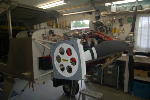

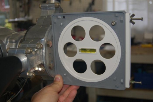

for the adj.  1st put the tool against the hub and set the 0.
then clamp the tool to the tip of the blade and turn it to 10 degree.
