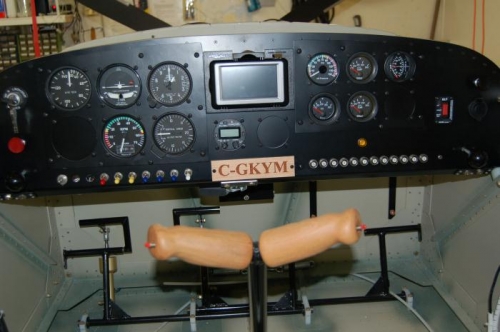

I wasn't satisfied with the amp meter that was installed first so, I decided to replace the volt meter and the amp meter by a dual meter.

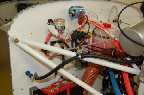

I also routed a return fuel line from the engine to the right fuel tank. There is a nipple on the top of the engine marked ''return to fuel tank''. It seems to have different way to deal with this connection but I decided to route a 1/4 fuel line back to the fuel tank. That's what Rotax recommend.

new shunt for the amp meter and the return fuel line
