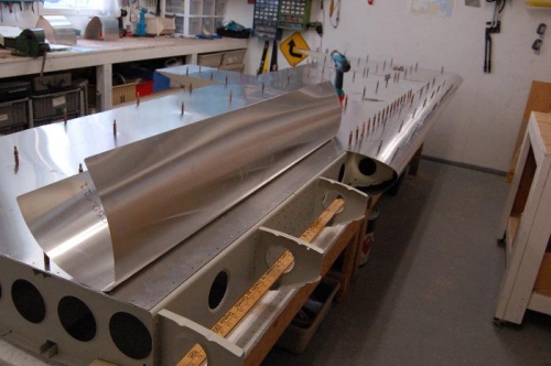

Brief Description:  Nose skin
Began to install the nose skin. Since my wing is actually upside down on the table, I positionned each nose skin (there is 4) and drill the line of holes on the spar first then continue with the holes on the nose ribs. Just pay attention to the measurement (180mm from the tip to the spar).
I then flip the wing over for tomorrow.
