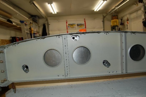

Brief Description:  Fuel tank
Installed the fuel tank in its place. Drill holes for the 27 nutplates. Install nutplates. After the fuel tank has been secured in place, I noticed that the holes in the rib #1 were not aligned with the fitting holes of the fuel tank. I had to enlarge those holes.
Finish to drill and clecoed the wing tip.
