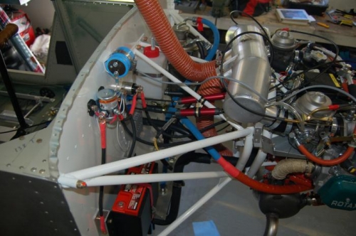

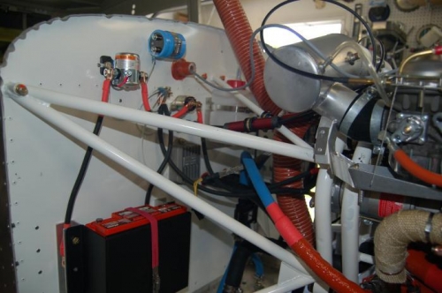

Date:  7-10-2011
Number of Hours:  4.00
Brief Description:  oil & coolant hoses
Finally install the oil hoses and the thermostat. Also the coolant hoses to the radiator with specially made aluminium tubing with a 5/8 exit to the cabin heater radiator. I added a valve on that 5/8 hose to control the heat.
All the big wires for the battery and the starter are in place.
few clamps missing
few clamps missing
