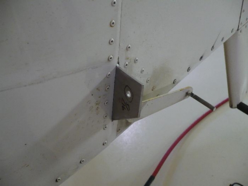

Trimmed about 3mm off the braces of 6B15-4 so the original holes would line up with the original center spar rivet holes.

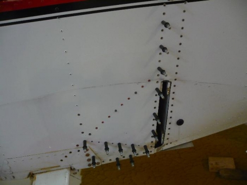

Placed bottom doubler and transfered rear rivet line, clecoed.

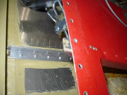

Rear spar Attach Plates clecoed.
Trimmed about 3mm off braces
Bottom Rear Doubler placed
Rear spar attach plates
