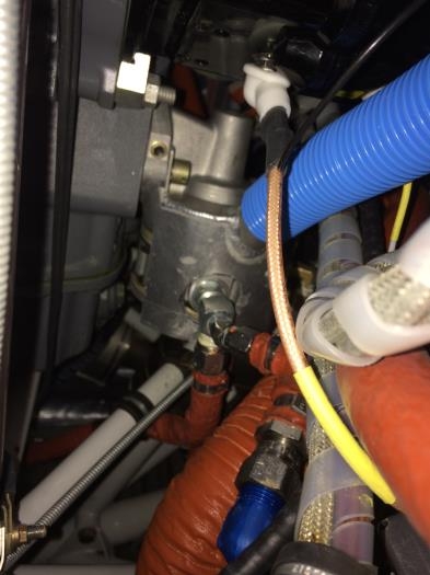

Brief Description:  Replaced Fuel Pump and added Cooling SHroud

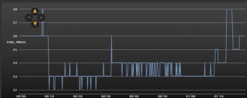

All is finally well! I ended up replacing the fuel pump and added a cooling shroud and blast tube to keep the pump cool. The pump never dropped bellow 22psi during the hour long flight. Now I can start resuming normal Phase I flight testing. Thanks to Steve Beaver for assisting with the pump installation. I also inspected the fuel filter and it was perfectly clean.
