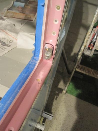

Another day on the left door. Janice provided third hand support. I trimmed about 1/16" off the bottom of the door.
Installed the delrin base for the safety latch. I had to trim it down a bit so that the latch will clear the base.
Drilled holes for the door pin guides.
I still have to remove the fiberglass behind these guides and most likely I will still have a bit of door trimming lerft.
Safety Latch Base
Door Pin Guide
