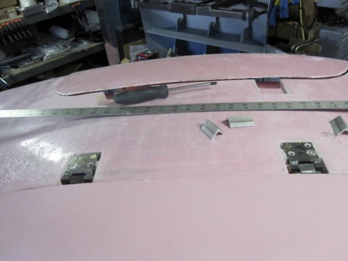

Drilling the hinge mounting holes

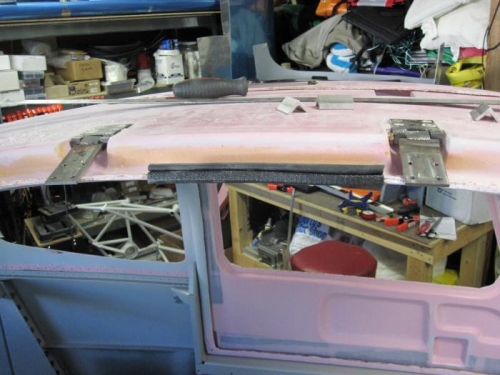

Right door hinges mounted
