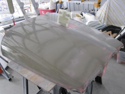

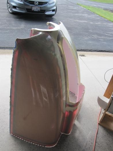

Janice finished applying the epoxy top coat to fill pin holes on the top and bottom cowl.

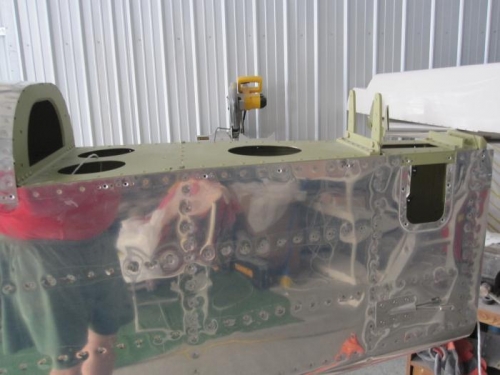

I worked on installing nut plates on the tail for the empennage fairing. I noticed that I didn't dimple the access panel holes when those nut plates were installed some time ago, so I drill them out, dimpled, and riveted back in again.
