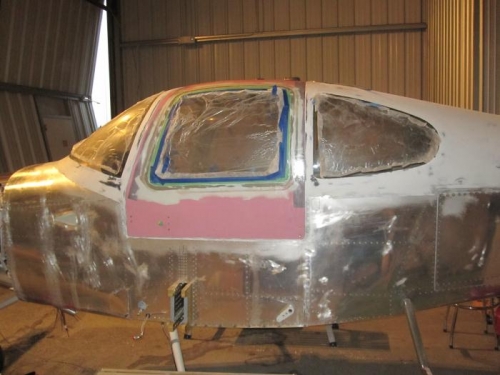

I rehung the doors so that I could install the hinge cover plates that I got from Don McDonald. There are some fit issues, so I have to think about the install some more before proceeding.
Janice started sanding the lower cowl and scoop in prepartion for applying epoxy to fill pin holes.

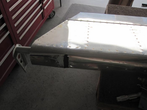

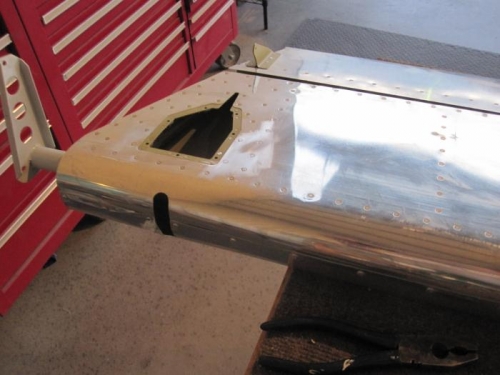

Awhile ago when the elevators were removed, they got damaged. One elevator had a crack in it. I stop drilled the hole. Then I made a doubler and riveted in it behind the curve. The other elevator just had a dent. I then applied some body icing to cover the dented areas.
