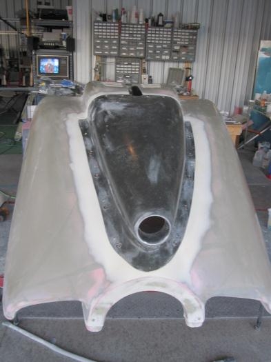

Janice sanded the cabin cover door frames where icing had been applied yesterday and started to clean up the fuselage.
I sanded the areas on the cowl and scoop where micro was applied. I finished riveting the Milspec fasteners to the cowl. I screw on the scoop to the cowl for the first time. This sets the depth on the fastners (the depth is adjustable). I had some troubles since the set pin kept falling out on a few of the fasteners, but finally was sucessfull.
It appears that the gap between the scoop and the micro fillet on the cowl is too tight. I'll have to sand the scoop a bit for a larger gap to accomodate the paint.
