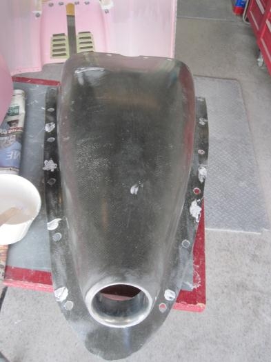

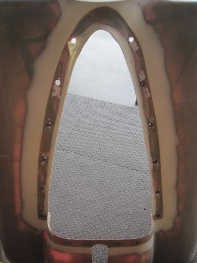

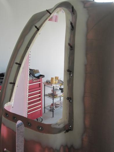

Brief Description:  Cowl and Scoop
I finished drilling all the holes for the milspec quick release fasteners to attach the scoop to the lower cowl. I botched a couple of the counter sinks, so I had to fill in with micro. I also filled the cleco holes on the scoop with micro. We we able to get about half of the fasteners riveted to the lower cowl
