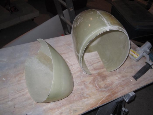

Brief Description:  Wheel Pants #11
48-15, Steps 1 & 2
The nose wheel fairing is a two piece fiberglass assembly. It attaches to the nose wheel fork with brackets riveted to the wheel fairing . NOTE: The nose wheel fairings must remain transparent to accomplish the installation. Do not sand or prime their interior or exterior surfaces until directed to or upon the completion of the installation.
Fit the U-1013A Wheel Fairing Front and U-10138 Wheel Fairing Rear together. The wheel fairing rear has a recessed lip on the front so the smaller wheel fairing front will fit flush. This lip may be uneven. Trim it to a constant width.
Fit the U-1 013A Wheel Fairing Front over the lip of the U-10138 Wheel Fairing Rear and trim, grind or file either of them as needed to achieve a good fit. Do not worry about a mismatch at the top center of the fairing halves since this area will be trimmed away later to clear the WD-1017 Nose Gear Leg Assembly. Tape them into a best fit position and place a reference mark across the seam. Use this mark to realign the fairings during assembly.
