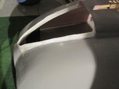

Janice assisted me again today with sanding the filler on the cabin cover. I didn't post any photos since it's next to impossible to see the progress in a photo.

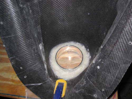

I installed the polished aluminum ring in the carbin fiber cowl scoop. It is held in place with some flox. There is a little epoxy that leaked out the bottom, but I won't know how bad it is until my next session.
I also applied some micro to the fiberglass that I laid yesterday on the bottom cowl.

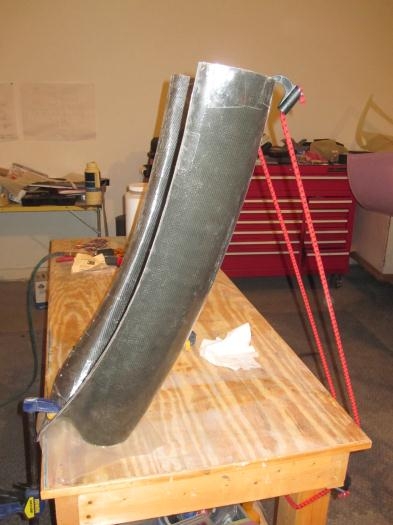

Scoop is vertical to keep the leading edge flat on the table
A rear view of the aluminum ring and the flox holding it in place
Micro applied to the fiberglass
