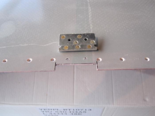

Cut a notch in the middle aft edge of the top cowl per the dimensions.
Fit the Cowl Upper Pin Retainer Assembly into the notch made previously. Match-Drill #27 the two screw holes in the F-1001Y Cowl Upper Pin Retainer into the top cowl.
Rivet the nutplates to the Cowl Upper Pin Retainer Assembly per the callouts.
47-8, Step 11
Machine countersink the holes just drilled on the top cowl.

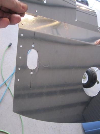

FF2-6, Step 4
Enlarge the #30 pilot holes to 3/4 dia. using a unibit, then remove the material between the two holes.

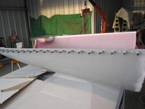

Top cowl machine countersunk and ready for riveting
