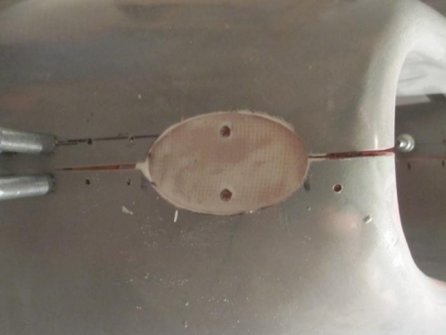

Brief Description:  Cowl Pin Hinge Covers #2
Aerosport Products Cowl Hinge Pin Covers
I removed the cowl pin hing cover templates, which exposed the four layers of fiberglass that Brad laid yesterday. I first drill the screw holes through the templates and the fiberglass. I then cut the new fiberglass along the centerline of the the joint where the two cowls meet. Next I installed a K1000-6 nutplate. The last step was to cut out the center of the template area so that the hinge pin can be removed. I still have a little work to do to make the opening more symetrical. Additionally, I have one hinge that doesn't quite line up due to too much fiberglass being underneath the hinge. I'll have to sand that down during the next session.
Finish cover in place
After nutplate mounted and hole cut
New fiberglass before cutting in half
