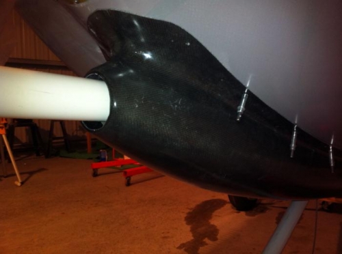

Brad assisted me this evening.
We took a different approach with installing the Rod Bower Ram Air unit. We centered the cowl scoop mod on the lower cowl and moved it to where it fit the best. We then adjusted the air filter to be centered in the cowl scoop mod opening. We used a short piece of pvc pipe to determine the extended center point.
We determined that the cowl scoop mod is actually too narrow and needs to be about 1/4" wider. I started using modeling clay on the cowl scoop to build it out about 1/2". I'll post pictures when it gets closer to the final form.
Cowl Scoop Mod clecoed in place
