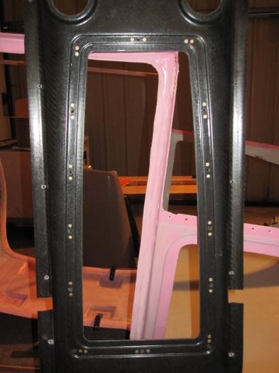

I started this evening by working on the overhead console. I riveted the eight nutplates that are in the corners. I don't recall the part number, but they are the ones with two lugs on the same side. I also drilled a couple holes for the map lights.

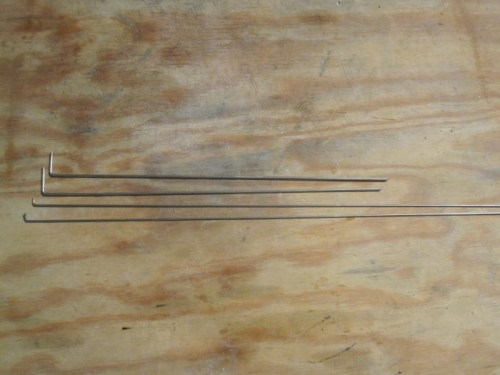

Make two F-1001 S Cowl top Hinge Pins from SSP-090 hinge pin per the dimensions. These pins will replace the soft aluminum pins provided for the F-1001N Cowl Attach Hinge.
Make two F-1001T Cowl Side Hinge Pins from SSP-120 hinge pin per the dimensions. These pins will replace the soft aluminum pins provided for the F-1001P Cowl Attach Hinge.
Grind the ends of the cowl pins. Offset the point.

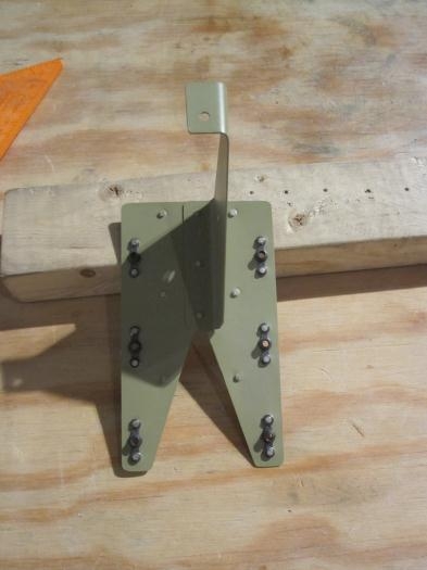

Rivet together the F-10108A Support Bracket, the F-10108B Splice Plate, and the F-10108C Plate
Corner nutplates riveted
Hinge Pins
Hinge Pins
Support bracket and Splice Plate
