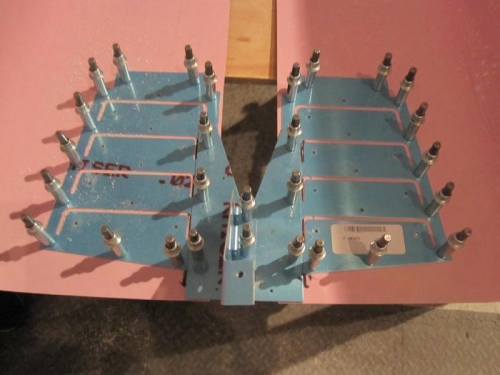

Cleco the two F-10109 Louvers and the F-10108B Splice Plate to the bottom cowl using the six nutplate screw holes drilled into the bottom cowl. Match-Drill #40 all of the 3/32" holes in both louvers into the bottom cowl. Cleco while drilling. Final-Drill #19 the six nutplate screw holes common to the louvers, splice plate, and bottom cowl.

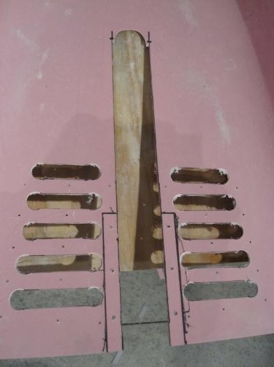

Trim the slot for the WD-1017 Nose Gear Leg Assembly so that it is even with the edges of the F-10109 Louvers.
Cut the ten louver slots into the bottom cowl. Start by drilling the holes in the center of the radius at both ends of each slot 13/16" then trim between the holes to finish the slot.
Chloe
Louvers and Splice Plate
Louver slots cut
