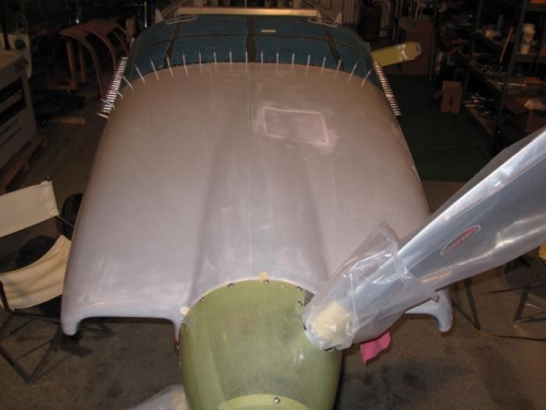

Remove the top cowl and from fifteen inches on either side of the centerline, trim the excess material aft of the line drawn in
Reinstall the cowl. The upper edge of the lop cowl should drop down onto both F-1001N Cowl Attach Hinges. If further trimming is requ ired remove the lop cowl and slowly remove material with a long straight sanding block.
Mark the forward edge of the skins onto the sides of the top cowl using the same method used before. Remove the top cowl and trim away the remaining excess material along the sides.
Top Cowl fitted
Top Cowl fitted

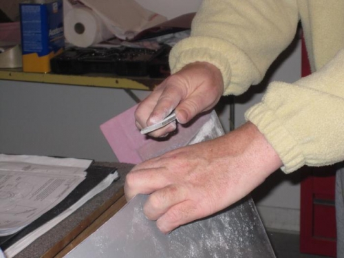

Slowly filing the rear edge
More filing
More filing
