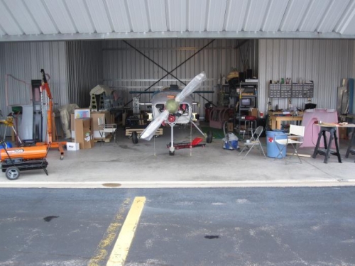

Today was also the first day that the hangar door was open in months. It wasn't really warm (50), but compared to the recent months it seemed warm.

First time in 2011 the door was opened
