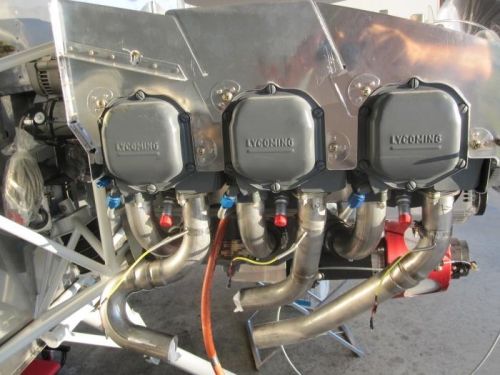

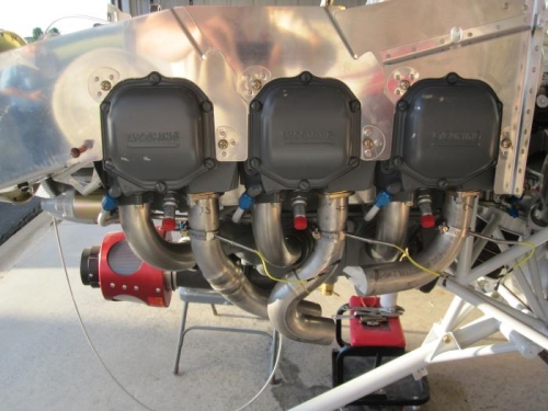

FF6-02, Step 3
Install the Stack Assemblies and EA GASKET 77611 Exhaust Pipe Gaskets to the engina using the hardware shown in the detail view in Figure 1. Use anti-seize on the exhaust port studs. Torque the exhaust nuts to 100-140 inch-pounds.

Left exhaust bolts torqued
Right exhaust bolts torqued
