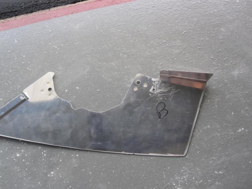

FF2-15, Steps 1, 2, & 3
Bend the CB-1003A Cylinder 2 Baffle using a wooden block (double check that you are creating the bend in the proper direction). Complete the bend by tapping along its length with a flush rivet set in a rivet gun turned down low. Adjust the final bend angle with a hand seamer to match the angle of the CB-1002A Fwd Left Air Ramp. Repeat for the CB-1009A Cylinder 1 Baffle.
While the right side went better than the left.

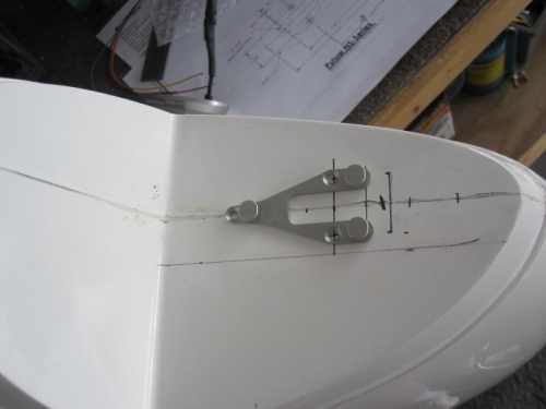

I started looking at where to mount the NAV lights in the wing tips. I decided to install them on the seam. I think they look better there than centered due to the asymetrical shape of the wing tip.
Flange bent correctly
NAV light placement
NAV light placement
