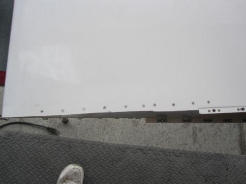

24-3, Step 7
Rivet the wing tip rib to the wing tip per the callout. I revited the bottom of the right wing tip.

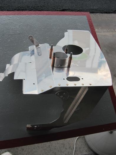

FF2-6, Step 8
Rivet the CB-1007B Aft Right Support Bracket to the CB-1007A Right Aft Case Baffle. Rivet the CB-100BA Cylinder 5 Baffle to the CB-1007A Right Aft Case Baffle. Rivet the VENT DL-03 Scat Tube Flange and VENT SCREEN 3X3 to the CB-1007A Right Aft Case Baffle. Rivet the CB-100BB Stiffener to the CB-100BA Cylinder 5 Baffle. Rivet the CB-1003C Doubler Plates to the CB-100BA Cylinder 5 Baffle.

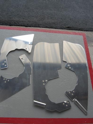

FF2-7, Steps 1, 2, 3, 4, 5, 6, 7, 8, 9, 10, 11, & 12
Cleco two CB-1003C Doubler Plates to the CB-1003A Cylinder 2 Baffle. Final-Drill #40 the rivet holes common between the doubler plates and the cylinder 2 baffle. Deburr and dimple the rivet holes Rivet the two CB-1003C Doubler Plates to the CB-1003A Cylinder 2 Baffle.
Cleco two CB-1003C Doubler Plates to the CB-1003B Cylinder 4 Baffle. Final-Drill #40 the rivet holes common between the doubler plates and the cylinder 4 baffle. Deburr and dimple the rivet holes. Rivet the two CB-1003C Doubler Plates to the CB-1003B Cylinder 4 Baffle.
Remove the hatched area from one CB-1003C Doubler Plate to make a CB-1009C Doubler Plate.
Cleco the CB-1003C and CB-1009C Doubler Plates to the CB-1009A Cylinder 1 Baffle. Final-Drill #40 the rivet holes common between the doubler plates and the cylinder 1 baffle. Deburr and dimple the rivet holes drilled. Rivet the the CB-1003C and CB-1009C Doubler Plates to the CB-1009A Cylinder 1 Baffle.
Cleco two CB-1003C Doubler Plates to the CB-1009B Cylinder 3 Baffle. Final-Drill #40 the rivet holes common between the doubler plates and the cylinder 3 baffle. Deburr and dimple the rivet holes drilled. Rivet the two CB-1 003C Doubler Plates to the CB-1009B Cylinder 3 Baffle.
Right Wing Tip Bottom
Cylinder 5 Baffle
Cylinder 5 Baffle
Cylinder 2 Baffle, Cylinder 4 Baffle, Cylinder 1 Baffle, Cylinder 3 Baffle
