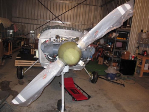

47-03, Step 12
Attach the propeller to the engine according to the propeller manufacturers instructions. Brad assisted me in installing the prop. Per the instructions, clean the hub and flange with MEK to ensure that it's clean. The angle of the prop was dictated by the keyed hole for the 0 position.
I haven't done the final torque yet, since I'm still waiting for the special torque adapter for the Hartzell prop from Avery.
Prop Installed
Prop Installed
Tightening the prop one quarter turn at a time
Using the engine hoist to get the prop in place
