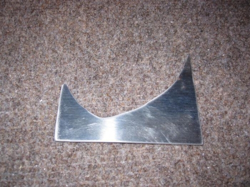

From AS3·063 aluminum sheet, make two S-1001 Gap Fillers and two S-1002 Backing Plates. Once again, make sure there is a 1/16" to 1/8" clearance between the propeller blade and gap fillers. I started rough fitting the first filler, but will need to continue during next session.

Filler plate rough cut
