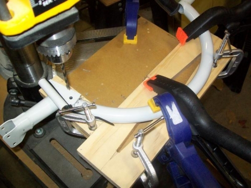

Brief Description:  Right Control Stick
39-7, Steps 1, 2, 3, & 4
Clamp the WD-1 011-L Right Control Stick Base to a drill press table. Insert a WD-1012 Control Stick into the control stick base as far as it will go. Rotate the control stick until it is planar with the surface of the table. Match-Drill #12 through the assembly using the hole in the control stick base as a guide. Support the control stick base with a block if necessary. Disassemble the parts and deburr.
Final-Drill the WD-1010 Control Column. Final-Drill theWD-1 011-L Right Control Stick Base and the WD-1 011-R Right Control Stick Base.
Install the WD-1010 Control Column onto the F-1033-L and F-1033-R Control Column Mounts. The right side is a mirror image of the left. The control column should rotate freely on the control column mounts.
