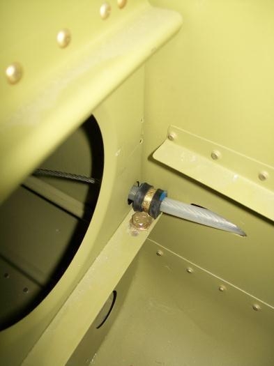

Insert the spade end of the Rudder Cable through the oval shaped slot in the aft end of the Tailcone Side Skin Left. Position the plastic sleeve so that both the oval slot in the tailcone Side Skin Left and the hole for the cable in the Fuselage Bulkhead are protected from the rudder cable. Cross the Rudder Cables over each other and insert them through the snap bushings in the Rudder Cable Bracket and Bulkhead.

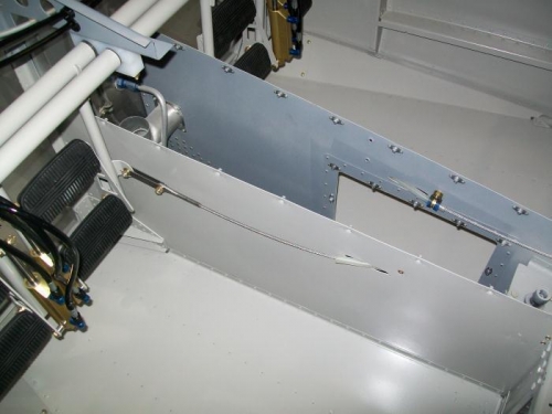

Install the guides to the Forward Fuselage Rib using the hardware. Clamp the forward most plastic sleeve on the Rudder Cable to the Forward Fuselage Rib. Position the plastic sleeve so that the oval slot in the forward fuselage rib is completely protected from the rudder cable. Position the plastic sleeve so that the oval slot in the forward fuselage rib is completely protected from the rudder cable. Repeat this step to clamp the other rudder cable to the Forward Fuselage Rib. Position the plastic sleeve so that the oval slot in the forward fuselage rib is completely protected from the rudder cable. Install the Rudder Cable Links between the Rudder Pedals and the Rudder Cables.

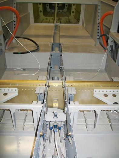

38-8. 38-9, & 38-10 Completed per plans.
Rudder pedal cable connection
Adel clamp holding the aft end of the rudder cable in the tailcone
Rudder cable in the tunnel looking aft
