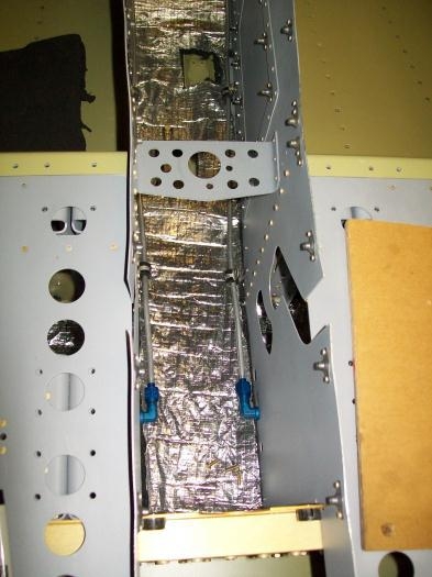

Brief Description:  Brake lines in the tunnel
36-3, Steps 1, 2, 3, 4, 5, & 6
Uncleco the VENT DL-10 2.40 Flanged Ducts and the VA-175 Heat Duct Tee from the F-1048-L and -R Fwd Fuselage Ribs and set them aside.

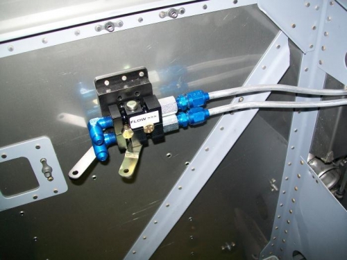

Install the AN833-4D Elbows to the F-6122-1 Matco Parking Brake Valve.
Using ATO-032X1/4 create both the left and right brake lines.
Slide four MS21919DG4 Cushion Clamps onto each brake line. Slide a 4D Nut and the a AN819-4D Sleeve onto each end of both brake lines.
Double check that Step 4 has been completed correctly, then flare both ends of each tube.
Attach the brake lines to the fittings at the aft end of the F-1048 Fwd Fuselage Ribs and the fittings on the F-6122-1 Tri-Gear Brake Bracket. Screw the cushion clamps to the nutplates using the hardware.
I have to get some stubby wrenches to finish the install. All my wrenches were too long to use to tighten the nuts in the tunnel. Once I get all the brake line nuts tighten, I'll finish putting in the adel clamps.
Parking Brake Valve
Parking Brake Valve
Brake lines in the forward part of the tunnel
Brake lines in the aft part of the tunnel
