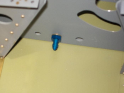

Using a Unibit enlarge the brake line exit hole in the F-1072 Fwd Fuse Bottom Skin to 5/8 diameter.
Install the AN837-4D 45° Elbow and AN924-4D Nut onto the WD-1021-L Landing Gear Mount - Left. Using the gear leg socket as reference, orient the fitting to aim down the gear leg.

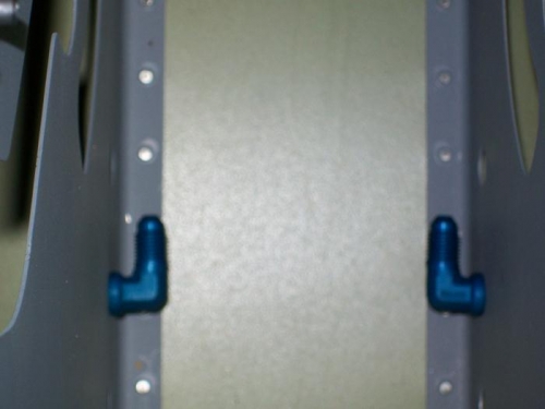

Install a AN833-4D Elbow, AN960-716 Washer and AN924-4D Nut to the F-1048-L Fwd Fuselage Rib.
Make a brake line from ATO-032X1/4 that connects to the bulkhead fittings and passes through the center of the notches in the F-1084A-L Systems Brackets.
Slip two SB375-4 Snap Bushings onto the inboard end of the brake line. Slip a AN818-4D Nut and a AN819-4D Sleeve onto each end of the brake line.
After making the first brake line I realized that I didn't keep the nut on the proper side of the bend, so I'll have to make another line tomorrow. The nuts won't slip over a bend in the brake line.
Fitting on the right side of the  tunnel
Fitting on the right gear mount and bottom skin
View of both fittings on the turnnel
